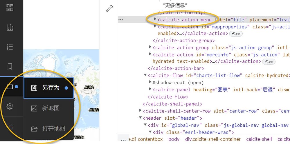

The "calcite-action-menu" is used as menu items of the action. In the document it is not available while in the map viewer it is used.

Hi @baohuachu2,
Action Menu isn't fully supported at this time, which is why it is not in the public facing documentation. We hope to clean it up and support it for the public in the future.
