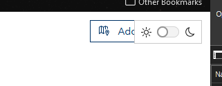

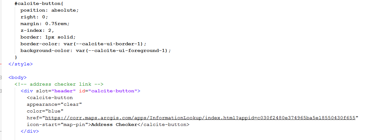

I am trying to get a button working on the header of my web map app but for whatever reason it shows temporarily only while the page is loading but disappears once loaded. Is there something I am missing? here is the code I am using for it. It is a simple button with a link to another app
Current code:

Hi @ArianaBernal, Leveraging the code you provided above, was able to load the button as-expected, but it looks like you have other elements that may be conflicting, such as the calcite-switch and some menus.
There's also an alternative to calcite-button that might work in this case. If you are seeking to provide a solution that floats above other elements in the interface, you could use the calcite-fab (Floating Action Button) if you are looking for a button with more visual prominence. There are a few differences from button, such as rounded corners and box-shadows, but could solve other conflicting visual elements.
