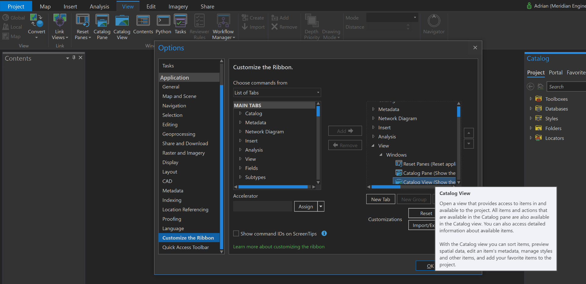

5. If nothing else works, right click somewhere in the blank space in the Windows area under the View ribbon, then click on Customize this ribbon. Here you can add your different options like Catalog Pane and Catalog View:

PeterSharkey
Yeah I think that's the problem, I'm running Pro 1.2. But I did find the add data button and was able to have some success. What I didn't realize was that I have to add a new map in order to make those ribbon functions turn on. I'm much happier with how it imports cad data. It keeps the line colors and line weights from the original; cad file.
