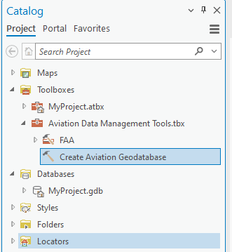

Hello, I have almost the same issue. I want to create an AIS GeoDATABASE so i have to add the Aviation Data Management Tool .
But when i use "Create Aviation Geodatabase" an error message "Tool has failed to open".
Please do u have any solution for that.
NB: I have only Aviation charting licence and my goal is to create and assess the obstacles for ANNEXE 4 ICAO.
DavidWickliffe
Hi Marcus,

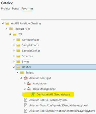

   That toolbox in your screenshot is for ArcMap.   For Pro,  you would install the Aviation Charting Product Files.   There is a Python toolbox with a 'Configure AIS Geodatabase' tool which you should use in Pro.
The help topic for it: https://pro.arcgis.com/en/pro-app/latest/help/production/aviation/set-up-an-aviation-geodatabase.htm
To download the Pro Charting Product files see, https://pro.arcgis.com/en/pro-app/latest/help/production/aviation/download-and-install-product-files...
