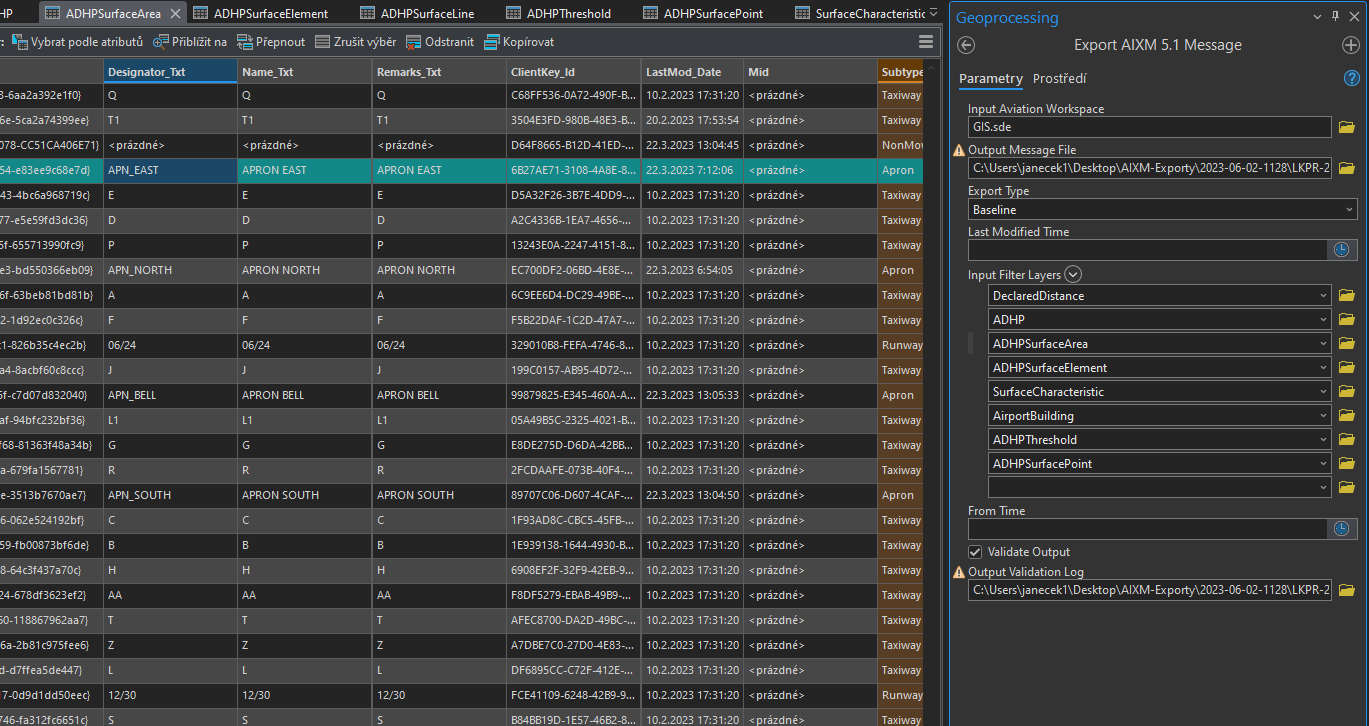

Hi, I am exporting AIXM5.1 format  from Aviation data model . Please, could you explain me what is this error?
Error: Line 96, Column 26: element 'aixm:designator' is not allowed for content model '(validTime,interpretation,sequenceNumber?,correctionNumber?,timeSliceMetadata?,featureLifetime?,name?,abandoned?,surfaceProperties?,associatedAirportHeliport?,contaminant*,annotation*,availability*,extension*)'
Thank you. Roman
KiyoshiYamashita
Hi Roman,
This is a known issue that will be addressed in a future release.  Essentially, the exporter is currently including the ADHPSurfaceArea::Designator_Txt attribute for apron features, but this is not supported in AIXM.  Thus, the validation is reporting the unsupported value that it's finding.
Until the fix is available, I've found that removing the Designator_Txt values for apron features (for example, the "APN_EAST" value you show in your attachment) before exporting to AIXM will avoid the validation errors as well.
