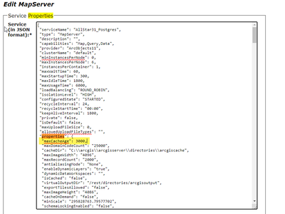

For the maxCacheAge, you can add only add it in the admin api, right under the properties of the mapserver of your service. I think if the default is 300 (5 minutes), is it not there by default. thanks for bringing up the issue that it isn't in the doc
