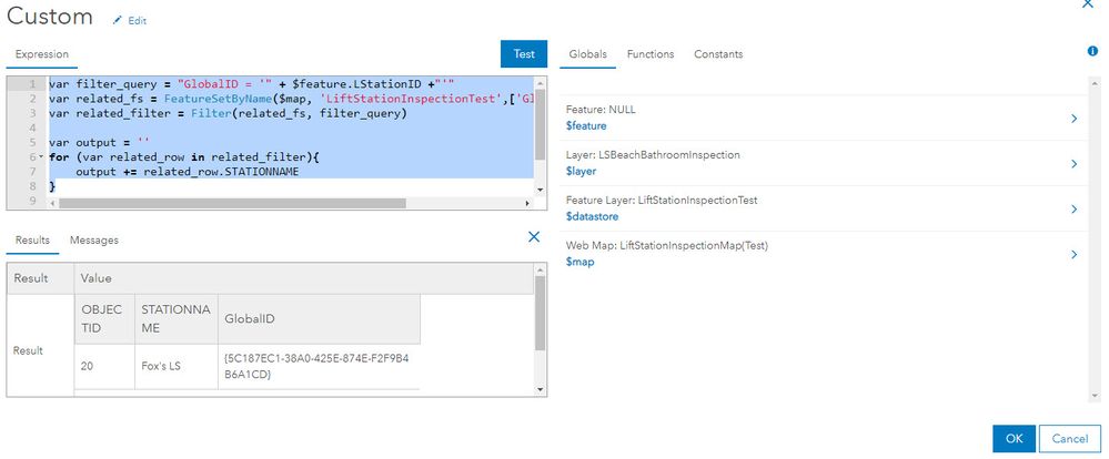

tested successfully in webmap but get error in attribute rules
1592
01-11-2021 03:45 PM
JuneAcosta
This script runs successfully when I test in the webmap against the service- see the attached image.
However, I get an error once I try to use in  attribute rules using ArcPro 2.7.x. I'm new to attribute rules, and will appreciate any help folks on this forum.
I have a liftstation featureclass with a related table for repeat inspections using collector. I need a rule that will populated the station name from the liftstation featureclass to a field in the related table.
I get the error "Invalid expression Error on line 6 General evaluation error" . It's failing at the line "{
output += related_row.STATIONNAME"}
Here's the code used in attribute rules.

HusseinNasser2
Hard to tell from the script whats going on, but I modified the script to be more readable and less error prune by using the inline sql semantics so it takes care things for us like adding single quotes or dates predicates
You get the error on that line because thats when Arcade actually executes the query filter, make sure that the stationId is actually a valid globalId.

JuneAcosta
Thank you. Now it validates in ArcGIS Pro- I also added a line to check for a valid value before populating the record. Now I will test that it works in the Collector app.
