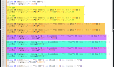

if ((parea > 0) && (billclass == ""V: Vacant"") && (dor < 6647 && dor > 5399)) {
newfee = (((parea/43560)*(12*(0.1*(12.138))))+242.76)
else if ((parea > 43560) && (billclass == ""V: Vacant"") && (dor < 5400 || dor > 6647)) {
newfee = ((parea/43560)*(12*(8.092 +(0.2*12.138))))
else if ((parea <= 43560) && (billclass == ""V: Vacant"")) {
else if (billclass == ""R: SFR"") {
newfee = (pimparea*0.12138)
// OIA
else if ((billclass == ""G: GOAA"") && (dor < 6647 && dor > 5399)) {
newfee = (((parea/43560)*(12*(0.1*(12.138))))+242.76) //119.88
// OEA
else if ((pimparea == 0) && (billclass == ""G: GOAA"") && (dor < 5400 || dor > 6647)) {
newfee = (((parea/43560)*12)*8.092)
else if ((pimparea - runway > 0) && (billclass == ""G: GOAA"") && (dor < 5400 || dor > 6647)) {
newfee = ((pimparea - runway)*(12*8.092)/2000)
else if ((pimparea - runway <= 0) && (billclass == ""G: GOAA"") && (dor < 5400 || dor > 6647)) {
newfee = (((parea - runway)/43560)*33)
newfee = ((pimparea - runway)*(12*5.4)/2000)
else if ((billclass == ""M: MFR"") && (dwell == 1) && (ouswwm == 'N')) {
newfee = ((pimparea/dwell)*0.12138)
else if ((billclass == ""M: MFR"") && (dwell == 1) && (ouswwm == 'Y')) {
newfee = (((pimparea/dwell)*0.12138)*0.58)
else if ((billclass == ""M: MFR"") && (dwell > 1) && (ouswwm == 'N')) {
newfee = (((pimparea/dwell)*0.12138)*dwell)
else if ((billclass == ""M: MFR"") && (dwell >1 ) && (ouswwm == 'Y')) {
newfee = (((pimparea/dwell)*(0.12138*0.58))*dwell)
else if (billclass == ""L: Lake"") {
newfee = 0
else if ((billclass == ""A: Comm"") && (ouswwm == 'N')) {
else if ((billclass == ""A: Comm"") && (ouswwm == 'Y')) {
newfee = ((pimparea*0.12138)*0.58)
else if ((billclass == ""O: Office"") && (ouswwm == 'N')) {
else if ((billclass == ""O: Office"") && (ouswwm == 'Y')) {
else if ((billclass == ""D: Delete"")) {
newfee = 0
return newfee;

Have you ever tried to use the When Arcade function?  I see some duplicate else if sections, but i'm not sure that's causing your issue.

Hello @LorindaGilbert  , perhaps the data has changed so it now follows a different path through your logic to an error that it avoided before ?
I don't like this section(s) : pimparea - runway > 0
Presumably you mean this : (pimparea - runway) > 0
But maybe it could be interpreted as this : pimparea - (runway > 0)
Otherwise, are you able to post a version of your code with hardcoded var values so that we can try it without your data, eg var dor = 6000 rather than var dor = $feature.IDFUseCode
