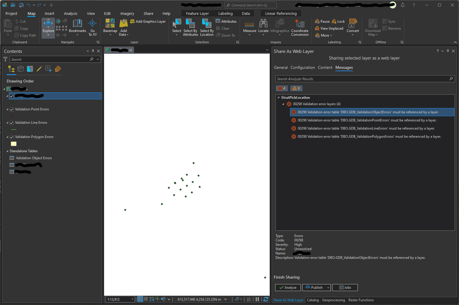

I'm trying to publish a feature service (and its two related tables) with Validation capability enabled, but I am getting error 00298: Validation error table must be referenced by a layer. I have all four validation layers in my map, so I don't understand why I am getting the error.
I've created attribute rules. The data is versioned (Branch), the service's Layer Configuration also has Version Management enabled (in addition to Validation) and in the Feature Properties it has Sync enabled. Disabling any of these options does not resolve the error. I've also tried deleting and re-generating the validation tables per: How To: Regenerate Validation Tables for Attribute Rules. This was also unsuccessful.
How do I resolve this error and publish my layer?

Check the properties of those validation layers.  What are the connection properties?

@MikeMillerGISI'm not sure what you mean by the connection properties. When I call connectionProperties on one of the validation layers this is the output:
{'dataset': 'DBO.GDB_ValidationPointErrors', 'workspace_factory': 'SDE',
 'connection_info': {'authentication_mode': 'DBMS', 'branch': 'sde.DEFAULT',
 'database': 'mydb', 'dbclient': 'sqlserver', 'db_connection_properties':
 'myhost\\myinstance', 'password': '<*********>', 'instance':
 'sde:sqlserver:myhost\\myinstance', 'server': 'myhost', 'user': 'myuser'}}
When I check the Source section of the layer properties, I get what looks like the expected data source properties. Is there a required property or something I should be looking for?

sjones_esriau
Make sure all UN layers and validation tables are selected when publishing as a web layer. Easiest to do through 'list by source' view in the contents.
I havent published for a while, hit this error, found this thread then remembered the steps....
