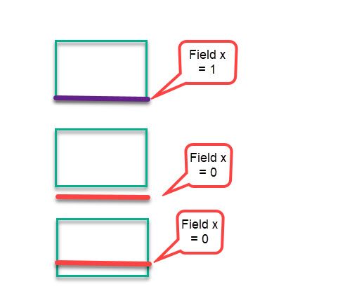

Is it possible to create a rule that flags polylines if it intersects along the boundary of a polygon.
I know I can get this if it intersects anywhere with Intersects(). Yet trying to create it if the line runs along the boundary.
Thanks in advance!

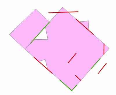

Thanks for the input. Unfortunately this doesn't give the output I'm looking for
I applied the rule to the Parcel Lines to check if the line was on the PlatIndex boundary (which is a polygon) for ease of viability. As you can see the non-intersecting (red) feature works as expected but the other (green) indicates its on the boundary. I'm looking to get a contiguous overlap.
