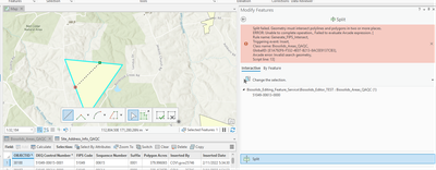

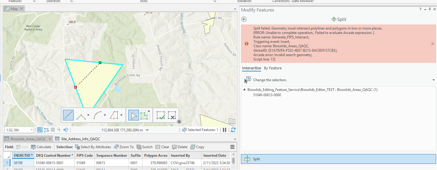

We had a series of attribute rules built out for our editors the methodically produce a unique permit specific ID field. One of the first attribute rules retrieves the county/locality FIPS code for a polygon feature upon create/insert, as this is used in the unique ID field. This works fine when drawing/creating a new record. However, I'm getting an ambiguous "Invalid search geometry" arcade error when trying to split an existing polygon feature in ArcGIS Pro.

Here's a screenshot of the error upon trying a split:

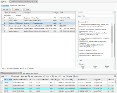

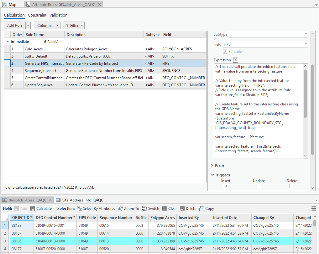

The offending attribute rule's properties:
It seems as though the problematic line below would indicate Pro isn't passing the "new" split feature as the search_feature / $feature into the following line properly...or I might very well be completely misunderstanding how splits are handled in the Pro client and sent to the geodatabase for evaluation.
