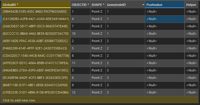

FlorianArtelt1
Thanks for your fast reply.
When using the provided syntax, we are still getting the cascade error message. We have deployed the syntax in three different projects with three different datasets and get the same error message. Nevertheless the recommended base condition seems to be logical and plausible.
We received the following dictionary for the "updates"-variable in line 18 after looping through the features.
[{"attributes":{"Pushvalue":null},"globalID":"{CA126DB3-A2FB-4421-A3A9-6DE3A91444A1}"},{"attributes":{"Pushvalue":null},"globalID":"{2A6CD837-5D17-4BFF-93C3-90433747E44E}"},{"attributes":{"Pushvalue":null},"globalID":"{82CCCC1C-BBA0-4462-BE59-B2302073AC7D}"}]
This seems to be valid.
Do you have any idea what's causing the issue?
Here you can see the sample attribute table. We just want to push the inserted value from the Pushvalue-Field to all features with that shares the same "GemeindeID".
Thanks in advance.

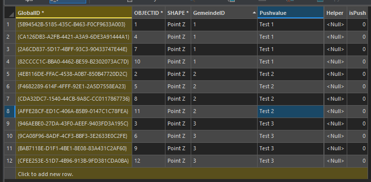

FlorianArtelt1
Thank you very much for your help.
When I use your code and then change a value, I no longer get an error, but no change happens to features with the same "communityID" neither.
However, as soon as I re-save the rule, I get the desired behavior and all values with the same "communityID" are adjusted. But nothing happens when I adjust a value by editing it manually.
I also don't quite understand what line 24 does in your script. Wouldn't it always break out of the loop here, since $featureValue is never equal to the other values when I make a change? Therefore my var updates dictionary remains empty? But if I change the operator to !=, the other values are not changed either.
FYI I work for the German distributor of Esri. Would it be possible if we could receive your test project or send you ours?
This is how my shema looks like with the new field "is push".
Screenshot: The desired behavior after saving the whole rule instead of edit individual features.

FlorianArtelt1
Thank you so much for your help! You are completely right.
It is sufficient to refresh the table view in the bottom right corner. When you are using labels, you can see the changes directly in the map! It works as desired now.
