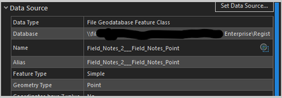

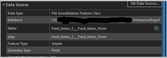

When I attempt to publish the two features as a web layer, I get an error, suggesting that referenced data is not compatible. To be clear, these datasets are not yet feature services; they reference data stored on the server.
(same is true with the polygon feature)
The referenced data store points to a folder on the server, where my FGDB (along with several other active registered FGDB's) is/are contained. Can someone help me to understand what it is that I'm doing wrong?
