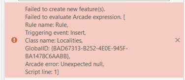

I get the following error..
Am I using the wrong function to return the annotation feature geometry? Or is it my Pro Version? 2.6.6

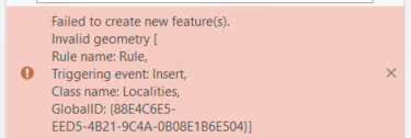

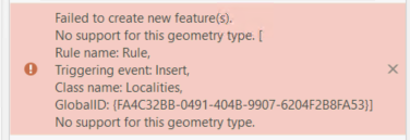

I did try Centroid() prior to posting, I get the following error:
Using featureGeo.rings[0][1] returns this error:
After these attempts, your statement "Annotation features seem to be treated as polygons." got me thinking so when I did the following, I got the desired output!
