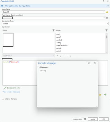

This link may help out, a solution states that it's not possible since ESRI didn't redirect the STDOUT to anywhere, but the solution underneath shows a way to perform this within a Calculate Field. I've used this before by creating a blank Feature Class with a few columns to create this test area, here is the link for that:
https://community.esri.com/t5/arcgis-pro-questions/where-do-the-arcade-console-messages-go-to/td-p/1...
And here is a screenshot of my efforts here:
This has helped me debug a few non-calculate field related issues, and it may be strange but this seems to be the only way to do it that I can find!
Hope that helps!
Cody

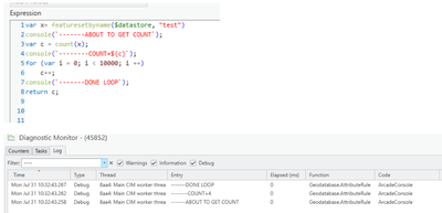

HusseinNasser2
To add to this thread, when using Console with attribute rules we write a debug entry in both server manager logs and ArcGIS Pro Monitor diagnostics. This helps tremendously in debugging. Here is a simple example
This was first introduced in Pro 3.2/11.2 and the fix has been ported to the following patches
- ArcGIS Pro 3.0.6
- ArcGIS Pro  3.1.3
- ArcGIS Pro 2.9.11
- ArcGIS Server 10.8.1 Utility Network and Data Management Patch 11
- ArcGIS Server 10.9.1 Utility Network and Data Management Patch 6
- ArcGIS Server 11.1 Utility Network and Data Management Patch 2
