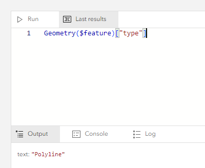

Haven't tried it, but I think you could use Geometry type for that.

Brilliant @RhettZufelt

You could also use
Lower(Geometry($feature).type)
For me the surrounding "Lower()" was needed in order to get lower case results (e.g. "polygon").
