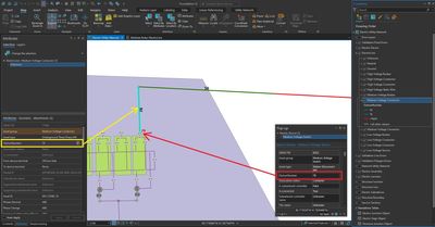

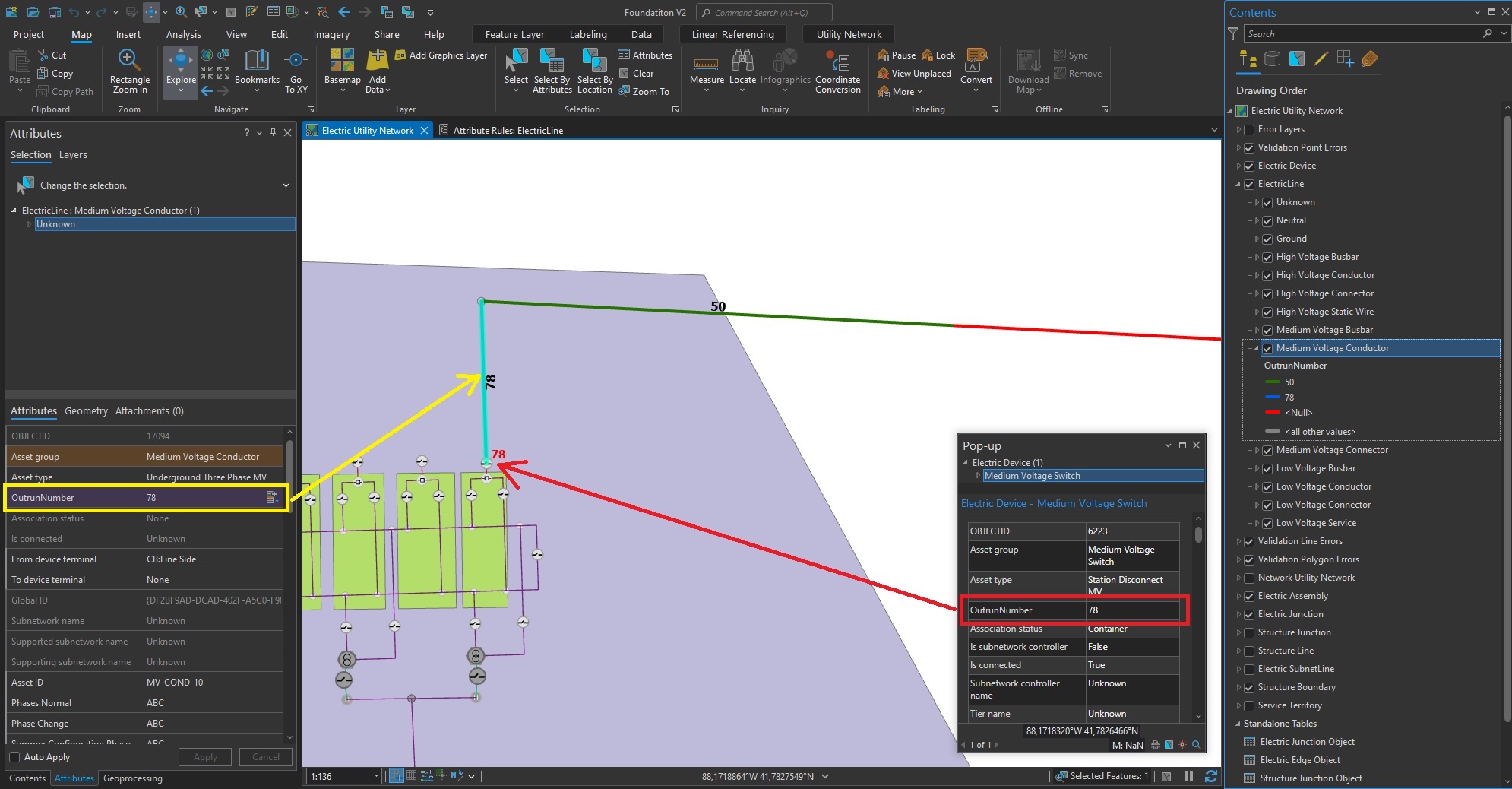

Hi everybody,
I prepared an attribute rule (batch) that will transfer the attributes in the "OutrunNumber" field in the Device layer to the "OutrunNumber" field in the Electric Line layer. It transfers this information to the line that intersects with the device layer. But the line consists of more than one piece. How can I transfer this information to the following parts?
I want to transfer this information to the green line and the following lines in the screenshot, how can I do this.
var fc_OutRunNumber = FeatureSetByName($datastore, "main.ElectricDevice",  ["OutrunNumber"] ,false)
var fc_MVS = Filter(fc_OutRunNumber,"ASSETGROUP in (37)")
var fc_Line_Intersect = Intersects(fc_MVS,$feature)
var fc_Outrun = First(fc_Line_Intersect)
if (fc_Outrun == null) return {"errorMessege": "OutrunNumber Not Found"}
return fc_Outrun.OutrunNumber

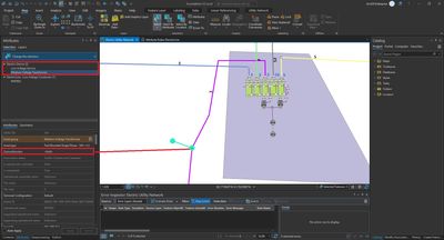

Ah, OK. For that, you need 2 rules (you should be able to do it in one, but I couldn't get it to work correctly, and it doesn't really matter).
The first rule is a variation of the rule in my previous answer. Instead of only calculating the OutrunNumber for Medium Voltage conductors, it will calculate for all conductor types (but it will skip connectors, banks, etc). And instead of traversing a line, it will traverse a network.

GIS_Solutions
Codes works fine, thank you for your support  @JohannesLindner
As far as I understand, it is necessary to determine which entities the attribute should be transferred to with the filter function.
