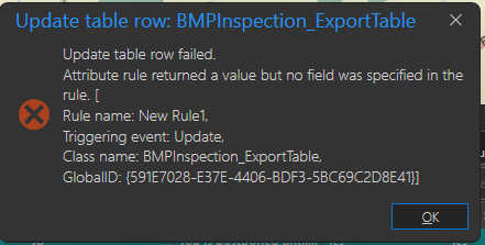

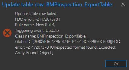

Hello, this is my first post so apologies for possible incorrect formatting or post location.
Very new to arcade and coding in general. I am trying to implement an attribute rule into my inspection table that triggers when an inspection is updated or created. Once this attribute rule is triggered it should populate a field in my permits layer stating the job has been completed. But  only if there is a final inspection type detected within the same permit ID (link field/ permit number).
Attribute rule triggers are insert & update.  Exclude from application evaluation is checked. My errors and code are below. Thank you!

MikeMillerGIS
Esri Frequent Contributor
Change return null to just return
Returning null means you are trying to set the assigned field to null.
MikeMillerGIS
