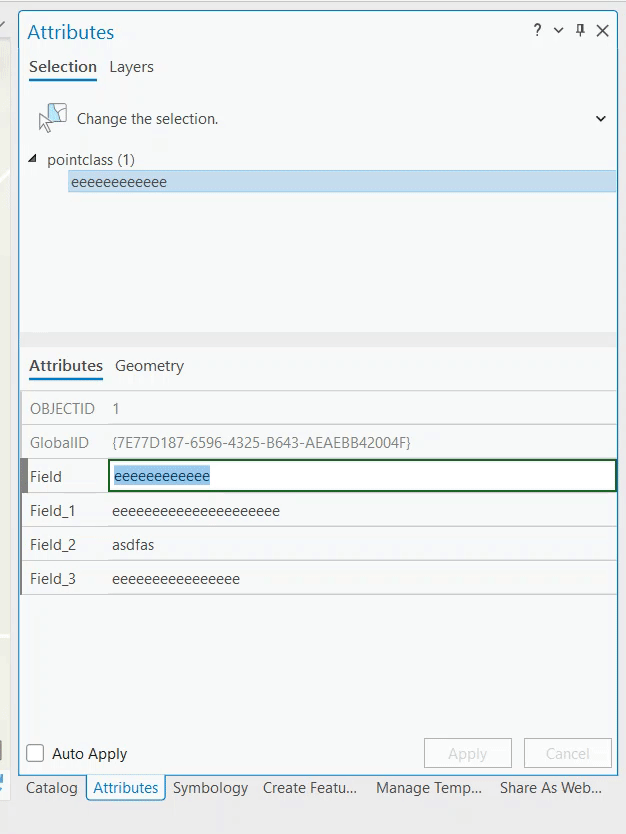

HusseinNasser2
As long as your rule is NOT excluded from client evaluation (there is a checkbox on the rule, leave it unchecked) and you have auto apply turn off (which is the default) then the attribute editor should not rollback the changes and will give the user the ability to fix their mistake. This means that edits are not sent to the database and processed locally in the attribute editor pane.
your rule should also have return true; at the end otherwise it will always fail.
