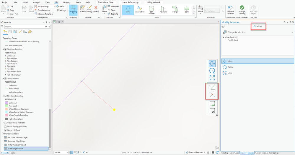

3) Depending on what the rule is relying on to confirm the points are exactly on the lines, you might check the snapping tolerance in the Pro projects and the XY tolerance in the feature dataset properties in both environments.
4) If this involves features in a utility network, you can also check the Connected/Disconnected setting on the "Move" tool in both environments.
Hope that helps. I'm interested to learn what the culprit is.

The 4th-Point is something I didnt knew existed. I will check if that will bring a solution.
Will keep you updated!
