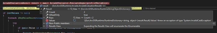

Hello! I have an expression "var d = Dictionary('Accounting', $feature.AssessmentID)\r\nreturn d" and if the value is null, I get an exception:
Values = '((Esri.ArcGISRuntime.RuntimeDictionary<string, object>)result.Result).Values' threw an exception of type 'System.InvalidCastException'
I researched that I could write like this "$feature.AssessmentID +'' " and no exception. Any other options?
Thanks.

Hi! Could you please help me? I have the same problem and I don't know how to solve it. I need to return dictionary from Arcade Expression, and work with it. But if at least one value is null, I get an exception and can't work with other values.
public override async Task ExecuteAsync(Feature feature)
Esri.ArcGISRuntime.ArcadeExpression ArcadeEvaluatorExpression = new Esri.ArcGISRuntime.ArcadeExpression("var d = Dictionary() \r\n if($feature.AuthorizationNotice == null) \r\n { d['QuantityActual'] = $feature.Status \r\n d['Assessor'] = $feature.DueDate \r\n return d}"); // $feature.DueDate = null
ArcadeEvaluator ArcadeEvaluator = new ArcadeEvaluator(ArcadeEvaluatorExpression, ArcadeProfile.FormCalculation);
List<KeyValuePair<string, object>> profileVariables = new List<KeyValuePair<string, object>>();
profileVariables.Add(new KeyValuePair<string, object>("$feature", feature));
ArcadeEvaluationResult result = await ArcadeEvaluator.EvaluateAsync(profileVariables); // here we have System.InvalidCastException
Dictionary<string, object> retValues = JObject.FromObject(result.Result).ToObject<Dictionary<string, object>>();
if (retValues != null)
   foreach (KeyValuePair<string, object> pair in retValues)
   feature.SetAttributeValue(pair.Key, pair.Value);
