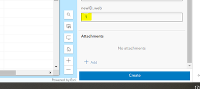

if I run the expression, the result is correct (see highlighted=501) as the last inputted no. id 500 in that field, but when I add a new feature in the editor I get 1.

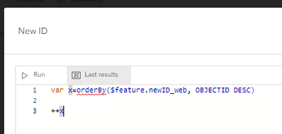

I suppose it is somewhere needed that I ask to order by let's say object ID like:
orderBy($feature.newID_web, OBJECTID DESC) and my attempt is a disaster as I don't know how to integrate the orderBy (last screenshot)
