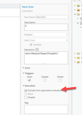

It looks like a bug reading the shape_length st function in the client side. I assume you are consuming the SQL Server feature class through a feature service? I can't reproduce this when running direct connect.
We will look into it, meanwhile as a workaround, try Excluding the Attribute rule from application evaluation and restart the service, that should do it. That will skip the client side evaluation and only do server side which we know it works.

LorenMueller
That was it @HusseinNasser2 .  Yes, reading/editing via the Feat Svc. Excluding from client eval works.  I think that this solution will work for my use case, but perhaps others will need this to work via client eval in the future, so thank you for sending the issue to the Pro team.
