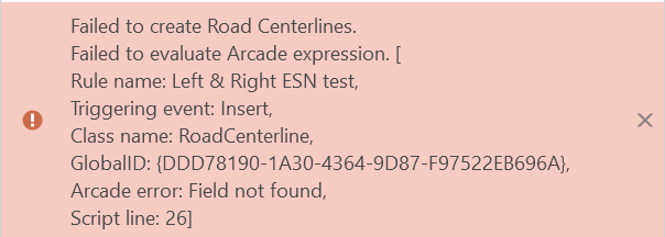

I recently upgraded to ArcGIS Pro 3.4.0. I can't say the upgrade is the culprit, but I have two attribute rules that are identical, they just pull different attributes from 2 separate feature classes, but one will not work.
The rule is a modified version of the "Left & Right Municipality" rule in the Address Data Management Solution. Below is the expression and the error. I'm really racking my brain because this rule did work initially, but something has changed that is causing it to fail now, which appears to be in a place that I have not modified the expression (Line 26). Any suggestions would be appreciated!

bbaker_tngeo
Thank you for the response, Hussein. I requested a case with Tech Support and was fortunate to get a quick resolution. The issue arises when the the feature class contains curved segments which requires an additional condition in the function. I believe the "curveRings" geometry type issue began starting in ArcGIS Pro 3.3.
Here is the summary of the resolution:
We discussed the rule is failing as the feature class has "rings" as well as "curveRings" geometry. We modified the function polygonToPolyline to include rings and the curveRings geometry using an else-if conditional statement and the rule started working as expected.

HusseinNasser2
My guess is you might need to account for empty geometries , line 26 points to this
      "paths": json["rings"],
which essentially means it couldn't find the "rings" property in the geometry object you sent to the function. So either you are sending something else (which your code doesn't look like it) or one of your features have an empty geometry that was recently added that broke your script..
