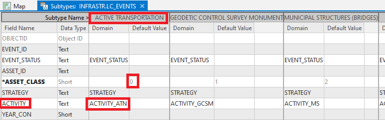

For a table that has a subtype:
The subtype fields have domains.

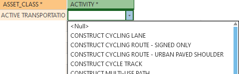

For example, when the ASSET_CLASS subtype value  = 0 (ACTIVE_TRANSPORTATION), the ACTIVITY field uses the ACTIVITY_ATN domain.

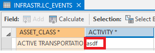

Just like with regular domains, subtype domains can be easily overridden via the Field Calculator and other mechanisms.
For example, 'asdf' is not a valid ACTIVITY_ATN domain code, but I can still enter that value via the Field Calculator.

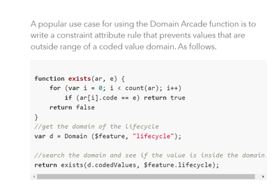

HusseinNasser2
I think I wrote a blog when we first introduced `Domain` Arcade function on how to do that.
https://www.esri.com/arcgis-blog/products/arcgis-pro/data-management/domain-subtypes-and-the-schema-...
The code is subtype agnostic but you should be able to get the Domain at the subtype level by passing the subtype code.
