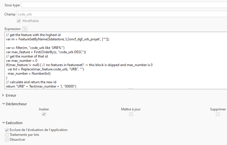

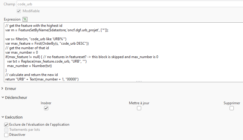

i have a probleme with attribute rule that execute twice in a feature service.
when i create record in arcgis pro through geodatabase evrything work perfectly for each record i create the ID increment by +1, but when i edit the data through  feature service in Arcgis Pro or with the Edit widget in web app builder its like the attribute rule is executing twice (URB00002, URB00004, URB00006....) +2 for each new record.
i checked Exclude from Application Evaluation but it always fire twice
i tried to put max instance = 1 but it didn't work
the arcade code of the attribute rule in the feature service is the same as the geodatabase, the only difference is the name of the table: in database its  "oncf.dgf.urb_projet" and in feature service its "L2oncf_dgf_urb_projet"
capture of attribute rule in geodatabase
capture of attribute rule in feature service
i use ArcGis enterprise 10.7.1 and arcgis pro 3.0.1
is there a way i can fix this probleme
thanks for you help
