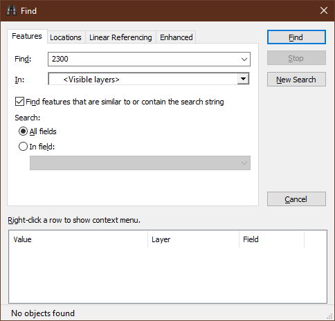

2) The Find Tool can not query these layers.

I'm wondering if anyone else has experienced this, or if anyone else has any direction on this issue. I find it a bit strange to be seeing this behavior considering that OGC Geopackage has been supported in ArcGIS Desktop since 2014 (10.2.x), and ESRI was a member of the steering committee that helped draft the OGC Geopackage standard.
As this behavior currently stands, I can not store vector features in an OGC Geopackage and hope to have users with ArcGIS Desktop/Reader interact with these data successfully.
