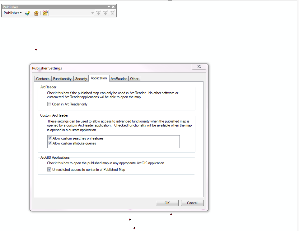

Hi Gary,
You need to assign permission to the pmf at the time when you create the pmf. If you publish the pmf from ArcMap, then you need to check Publisher Toolbar > Publisher menu > Settings > Application tab:
Uncheck: Open in ArcReader only
Check: Unrestricted access to contents of Published Map
Like the following screenshot:
Click OK. Then republish the same map as pmf. This new pmf should be able to load in customized ArcReader tool (or ArcReaderControl)
