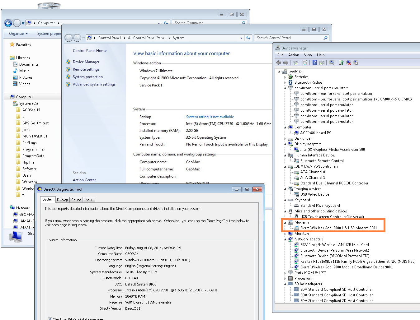

Both ArcPad 10.2.1 and Windows 7 are installed on Algiz 7 machine

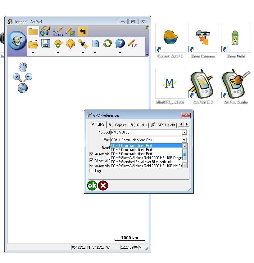

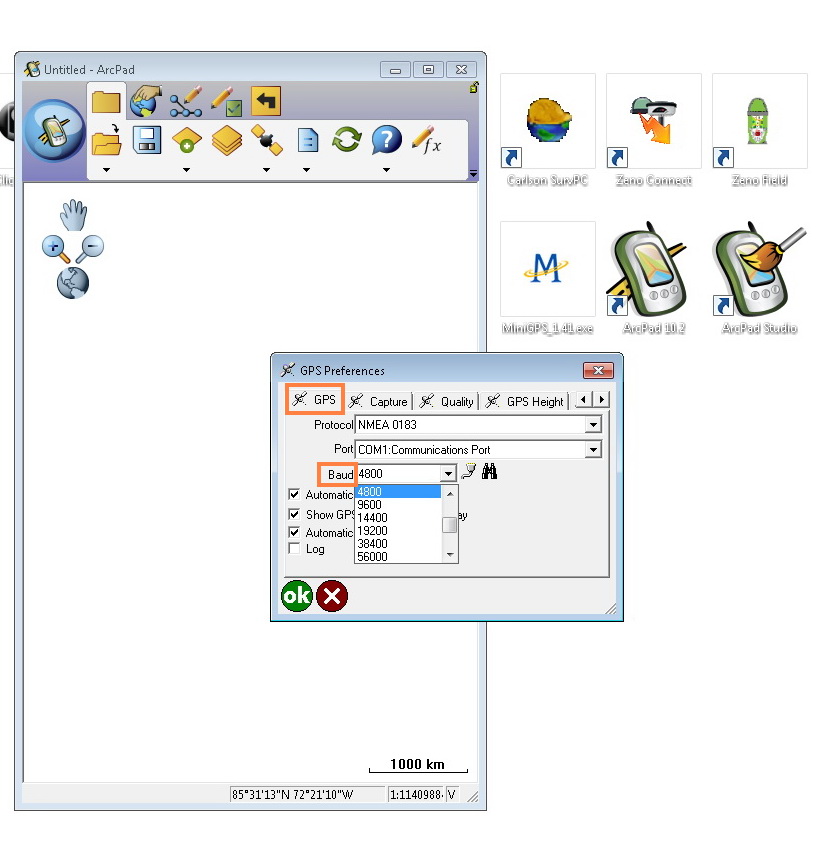

which GPS settings (protocol, port and Braud) should let the ArcPad work on this GPS handheld.
Are there other settings that should we do care about?

The Handheld USA Algiz 7 manual has specific instructions for configuring the GPS. It states that the GPS is on COM3 with a baud rate of 9600.

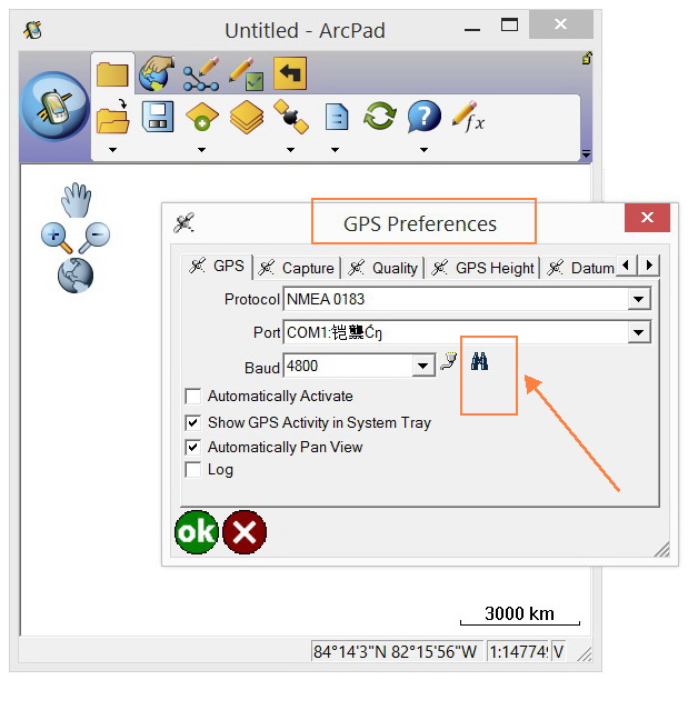

Should clicking the “find” icon (below) acquire the appropriate settings (protocol, port and Baud) automatically?
