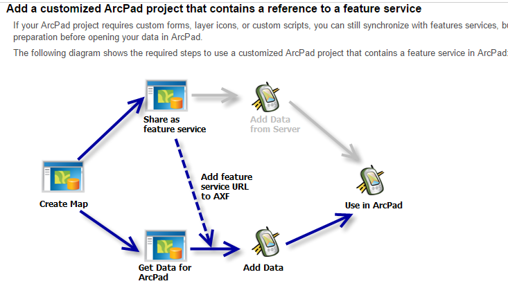

We are following this workflow. Create the check out and then add the URL

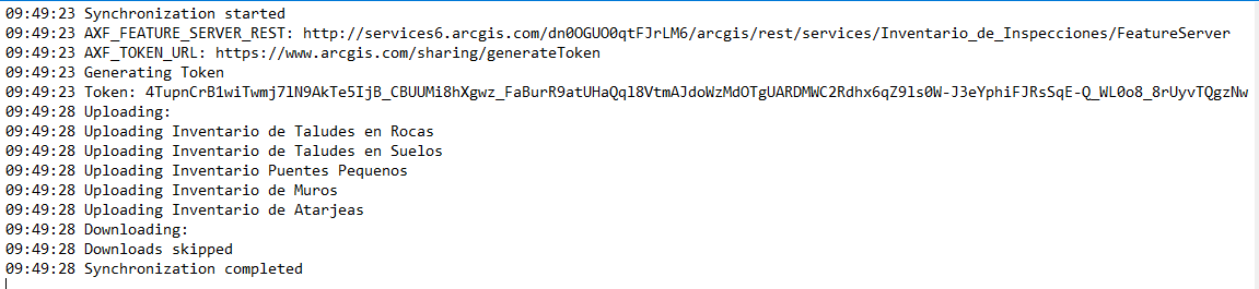

When we try to sync to Online we do not get any error

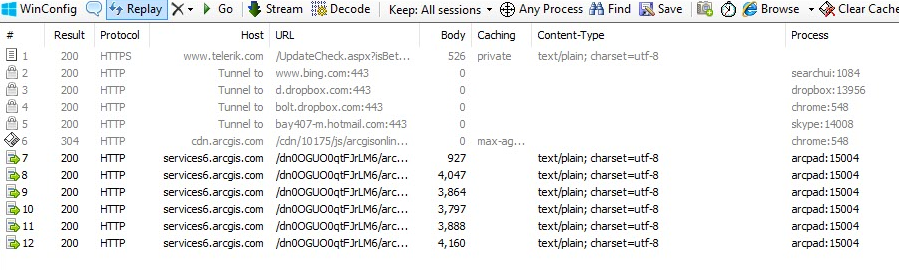

We verify using Fiddler but we didnt get any error

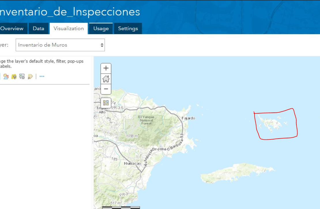

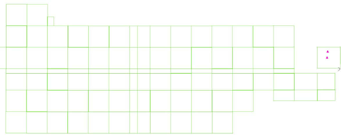

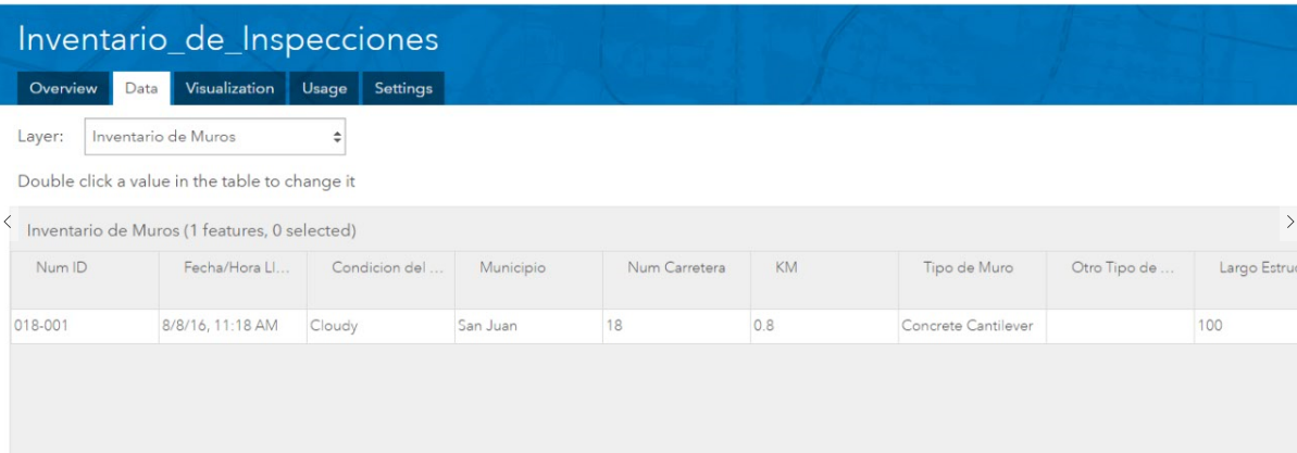

after we sync in ArcPad, although we do not get any error syncing, we do not see the data on the feature service hosted in ArcGIS Online.
We do not see any new data. The one that exist was done using Collector
We suppose to have 2 items in Culebra island but we don't have any, and in ArcPad we can see them

I recreate the workflow.
Shared the feature service to ArcGIS Online,
Download the layer
Do check out
used the tool add feature service URL to AXF
then collect a point using arcpad
and it sync
So, something got corrupted somehow.
