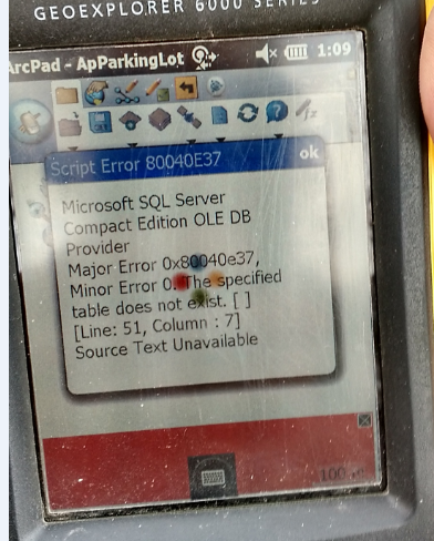

I have an ArcPad project that runs fine in ArcPad 10.0.4 but I get the attached "script error 80040E37" when I open it in ArcPad 10.2 on a Win 7 64bit desktop. When I clear the error it seems to work fine. Any thoughts?

Gregg,
What Marika suggests is to remove the applet from ArcPad itself. On my 64bit computer it is located at C":\Program Files (x86)\ArcGIS\ArcPad10.2\Applets". Remove all the files that start with "QuickField" (save them somewhere else in case you need them in the future) and give it a try. It worked for me.

Our set up is: A GeoXT 6000 running Windows Mobile 6.1, ArcPAD 10.2 for Mobile, Trimble Positions Add-in for ArcPAD 10.2.
On PC: Windows 7 64bit SP1, ArcGIS Desktop 10.2, ArcPAD 10.2 for Desktop, Trimble Positions Add-in for Desktop 10.2.
I was receiving the same SQL error:
In order to remedy this solution I had to remove the QuickField Applets from the GeoXT 6000's program files.
Located at DeviceStorage/Program Files/Arc Pad/Applets
I created a sub directory called quickFieldBackup and moved all of the Files that started with QuickField into this.
Everything work great after that!
Thank you a ton!

Appears this problem is corrected in the latest release of ArcPad. (10.2.2)
