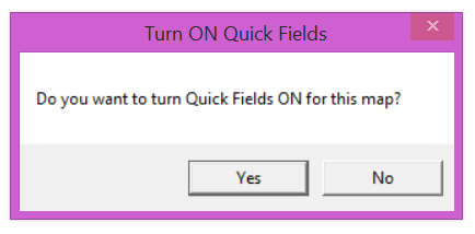

QuickFields are only applied to the map (.apm) - not in the data (.axf).
When ArcPad is in Design Mode - selecting the QuickFields tool will allow you to add and remove expressions. Make sure that all of your expressions have been deleted;
When ArcPad is NOT in Design Mode - selecting the QuickFields tool will switch QuickFields ON and OFF for your specific map (.apm).
Make sure QuickFields is turned OFF for your map.
