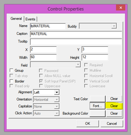

HannahFerrier
Deactivated User
Sorry Mike,
That is a limitation of ArcPad Studio - is is close to, but not a true WYSIWYG editing environment. You can see the placement of your controls on the form, but not so much fonts & colors.
To change your controls back to the original font type and size - use the 'clear' button
Hannah
