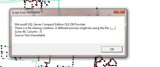

I am getting this error:
I get this error when opening the .apm file in ArcPad. Any suggestions?

Hi Robert,
I believe you are encountering a known bug:
NIM093688 Different Microsoft SQL Server Compact Edition errors when opening an .apm file in ArcPad 10.2, depending on whether the .apm is opened from a local or network drive.
Although its reported as a 'script error', it is not a fatal error. If the 'OK' button is clicked, the message is dismissed and the project should function normally.

RobertKirkwood
Jake,
Thanks for the information. The checkout/check-in works fine even though that error occurs.
