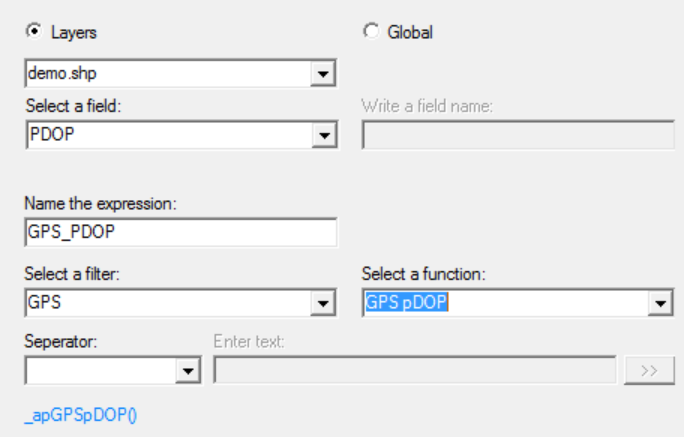

Have you looked into using QuickFields? QuickFields allow you to set up values to populate fields in your data automatically - including GPS data. You can build multiple expressions to apply to the one dataset to populate all of the variables you want.
Building your expressions in the Expression Builder - they should look something like this:
See the ArcPad Help for more information.
