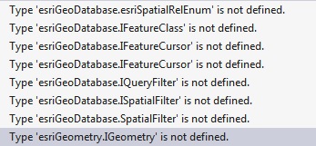

I want to perform a spatial search on ArcMap 10.2, cannot find proper sample for vb.net, what I found is the code from VBA. When I trying to convert it to vb.net, I encounter reference problem, the code is as following:

Then I got the following errors:
Not sure is it because the library difference of ArcGIS version? or what kind of library missing in my vb file? what shoukd I do to make it work?

Hi Li Yao,
If you have added the ESRI references already then the types in your code would change from
pFeatureClassIN As esriGeoDatabase.IFeatureClass
To this:
Imports ESRI.ArcGIS.Geodatabase
pFeatureClassIN As IFeatureClass
or (without the Imports statement):
pFeatureClassIN As ESRI.ArcGIS.Geodatabase.IFeatureClass
Regards,
Owen

Hi Owen,
Thanks for your quick reply. But I have already imported the necessary reference in the namespaces.

Hi Li Yao,
To this:
Regards,
Owen

Hi Owen,
Yes you are right. Thank you very much for the patient to a beginner.
