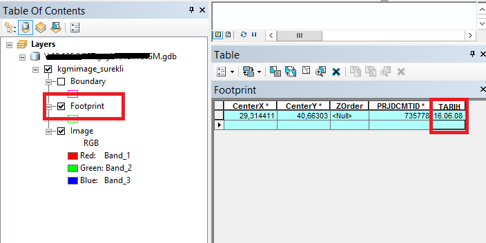

We have mosaic dataset with our mosaic datas, and we view our mosaic data from here. However, it is desired to sort our mosaic data by date (TARIH) by opening a date (TARIH)  field later.
Is it possible to avoid wasting time by using the program like ArcMap Tool (Arc Objects SDK Win app ) instead of adding one to the mosaic date and date information? If possible, can you share a sample link or code?
The table to be updated is a Footprint and its table is as in the picture.
Thanks For Helping

I think IMosaicDataset.Catalog returns a polygon featureclass containing the footprints.
This works for me (Adapted from here  )
