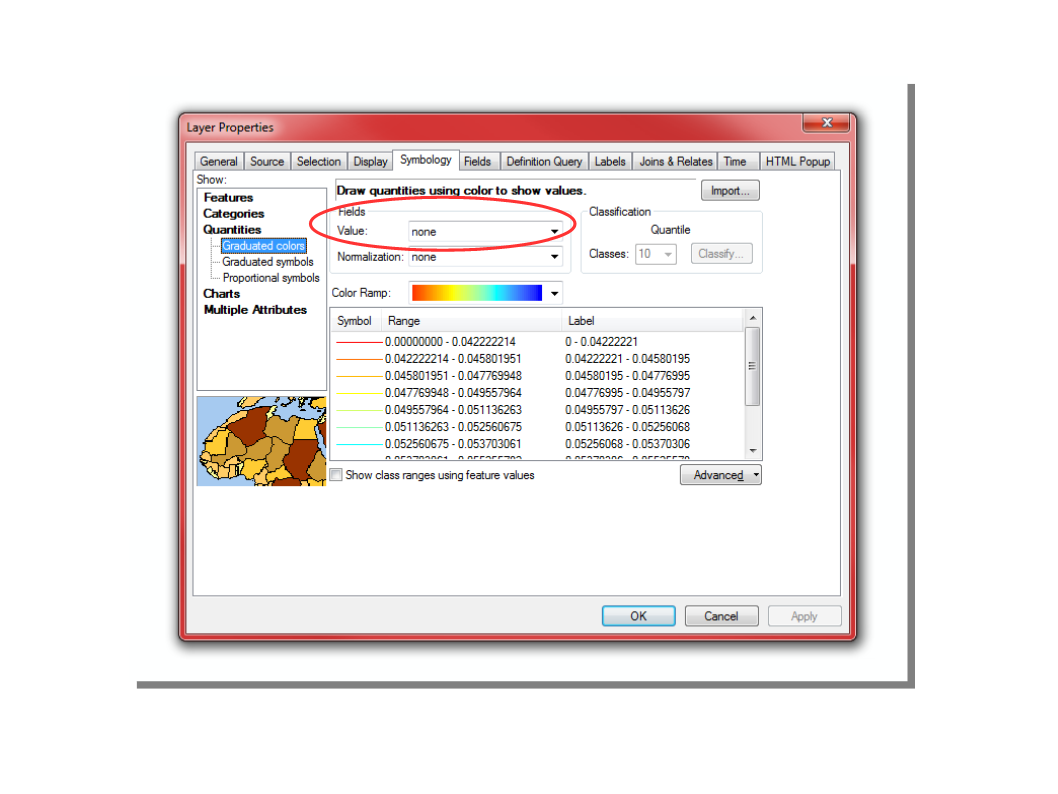

I am programmatically rendering a feature layer in ArcMap but I can't set the Field property in the Symbology properties form. This results in the layer having the correct render/breaks/legend settings but the on screen render is wrong. When I open the Symbology tab the Field isn't set. When I do select the field the classification is reset. The focus field is actually from a linked table. Any suggestions? Below is the code I have for rendering the layer.
I'm using ArcGIS 10.2.2; Windows 7;VS2010 Express. Feature layer is in a file geodatabase along with a linked table.

So Duncan it turns out it is an issue with the Joined table. Regardless of defining the field with the layer or table name the symbology fails to find the field. As soon as the joins are removed (and if the focus field is in the rendered layer) then the rendering happens correctly. So to get around this I now have to Join the table on the fly, do my calcs, then remove the join before automatically rendering the layer. In the end the original rendering code works fine and I don't need to use IFeatureRendererUpdate. Thanks for the help. I'll look into how to let support know about the issue.

My only suggestion is confirm that it's an issue with the joined field by copying the field into the dataset so the symbology is not based upon a joined field. If that fails then it suggest something subtle is wrong with the above code. If it succeeds then it's something up with it being a joined field? At that point I would fire it off to ESRI support as it could be a bug?
