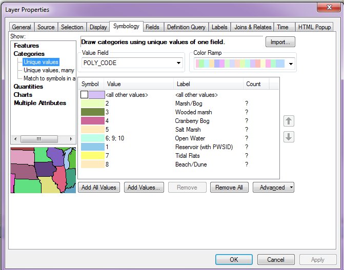

I want to print maps from my web application built with the ArcGIS Javascript API.
The requirements are:
1. need to show only legend elements that are within the visible extent of the printed map. For instance, if I have a feature layer that uses a unique value renderer I only want to show the legend items for the values present on the map.

This wasn't enough to get the legend behavior I wanted however. If a Marsh/Bog was within the extent of the map (see picture above) then it would show all wetland elements in the legend. I was able to solve this by creating a staged template that includes all the layers in the web map service (as detailed in this tutorial: http://resources.arcgis.com/en/help/main/10.2/index.html#//0057000000mq000000 ). This gives me everything I want but requires that I create a separate staged template for each map service. We have many map services and would need to keep the templates in sync with the web map services. Doing this for a dozen map services is a pain, doing it for hundreds is not feasible.
