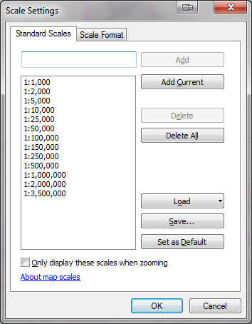

I've overridden the default scale range using ArcObjects 10.2 in ArcMap 10.2.1 .
IDisplayTransformationScales displayTransformationScale = (IDisplayTransformationScales)pActiveView.ScreenDisplay.DisplayTransformation;
displayTransformationScale.RemoveAllUserScales();
foreach (UtmZone20Enum utmZone20Enum in Enum.GetValues(typeof(UtmZone20Enum)))
{displayTransformationScale.AddUserScale((double)utmZone20Enum);}
displayTransformationScale.SaveDefaultUserScales();
pActiveView.ContentsChanged();
pActiveView.Refresh();
The range looks fine in the "Scale Settings" dialog , but it doesn't get refreshed to the actual "Map Scale" dropdown listbox when I call SaveDefaultUserScales() on the IDisplayTransformationScales interface.
IDisplayTransformationScales.SaveDefaultUserScales Method (ArcObjects .NET 10.1 SDK)
If I click on OK in the Scale Settings Dialog, it does get updated.
Is there a known problem with the SaveDefaultUserScales() method ?
Scale Settings dialog with changed scale range.
Thanks for any info.
