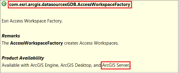

As per the API documentation, AccessWorkspaceFactory is available with ArcGIS Server too. Then what could be the reason for exception?
Can someone throw some light here.
