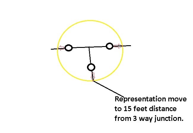

I am working on representation movement tool. In my project I want to move representation symbol (Only move representation symbol not feature geometry) within 15 feet from 3 way or 4 way junction. I got representation feature but I have searched option for representation moment in Arc Objects C#.Net. Please help me for my problem.
IRepresentation Interface (http://edndoc.esri.com/arcobjects/9.2/ComponentHelp/esriGeoDatabase/IRepresentation.htm)
After Getting Representation feature how to get and move Representation marker symbol in arcobjects:
