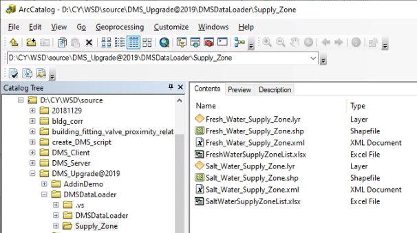

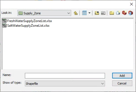

But when the GxDialog is opened, the shapefiles are not found.
But the shapefiles are found in ArcCatalog
Are there any problems on the codes? Thanks.
