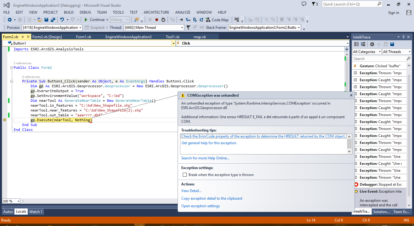

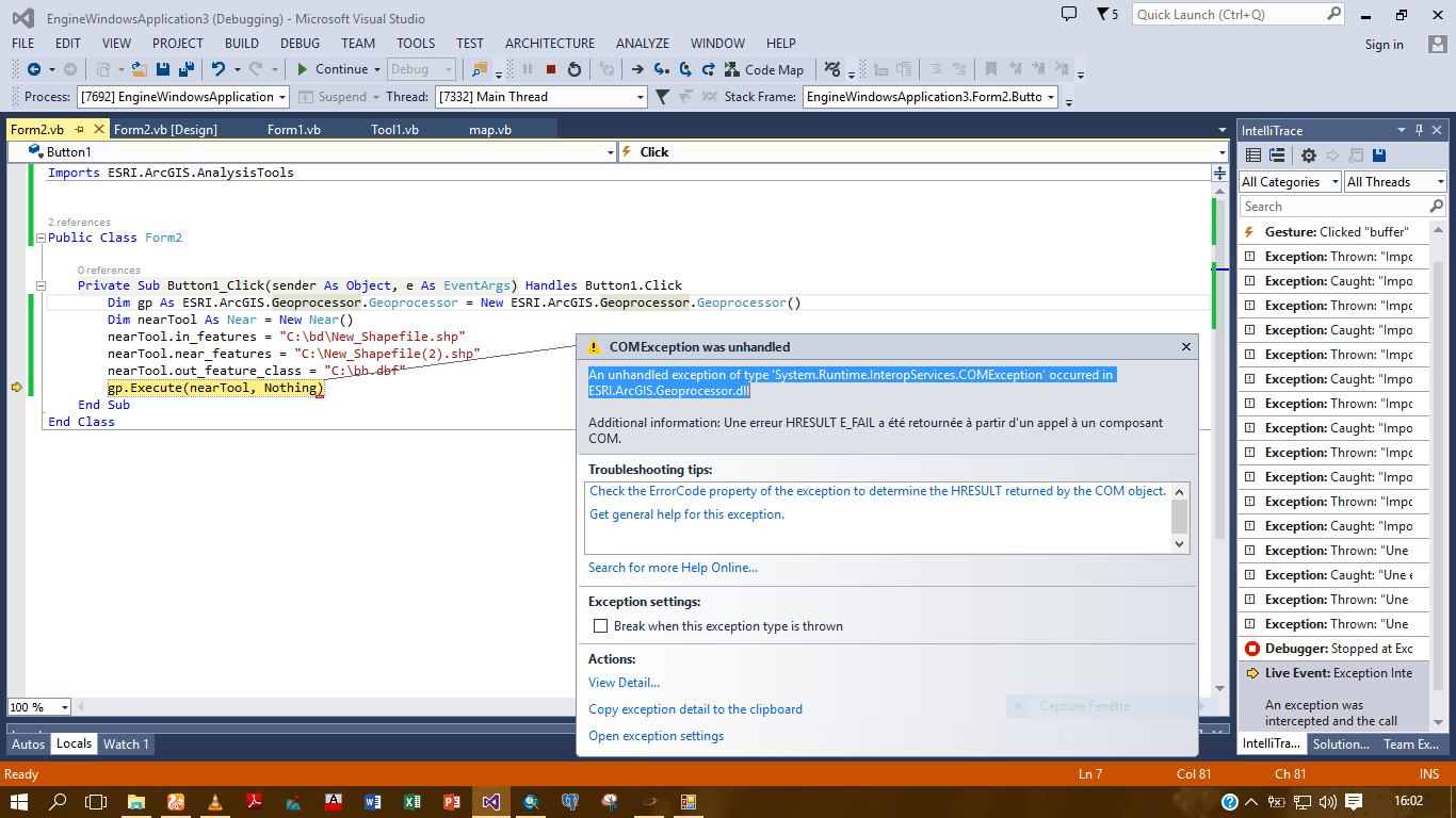

i am getting a serious problem with executing geoprocessing tools.
any time i compile the code it send me (An unhandled exception of type 'System.Runtime.InteropServices.COMException' occurred in ESRI.ArcGIS.Geoprocessor.dll) with the error code number -2147467259.
i am working with arcengine 10.3.1 on vb.net
here is an exemple of code:

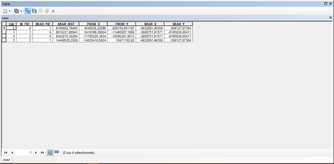

HichamEL_HAOUASS
Deactivated User
actually its working fine with arcmap. i changed Near tool with GenerateNearTable and i execute it with arcmap and its work but not with the code.
the problem persist for all geoprocessing tools except buffer which worked good.

DuncanHornby
MVP Notable Contributor
Looking at your screen shots I would say you need to define a full path to your output dbf file.  Also I can tell you are using Windows 10. Now I've discovered that even as the administrator is nearly impossible to write to the root c:\ drive, I think it's a windows thing. So make sure you write to a sub-folder that you have permission to write to. On my works machine I have a folder called c:\Local that I am able to write to.
