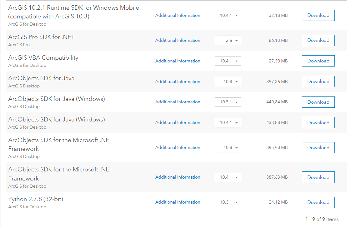

MarcoBoeringa
MVP Alum
This is the view of the available "Developer Tools" download in "My ESRI" for my Personal Use license, so ArcObjects SDK is available. However, I strongly recommend to develop in Pro's new SDK. ArcObjects is dead in the waters with ArcMap eventually going. Alternative is Python scripting. I developed an ArcMap / Pro and Python 2.x/3.x compatible toolbox with Python scripting that runs really nicely in both apps using the Python "future" package, so essentially writing 3.x code.
