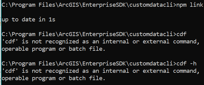

I've installed ArcGIS Enterprise SDK (Custom Data Feeds) and ran 'npm link' command that works. Tried to run 'cdf -h' command to verify configuration that didn't work.
I'm not quite sure whether I missed something during configuration or running command.
Any ideas or workarounds would be highly appreciated.

I had the same issue and had to go to C:\Program Files\ArcGIS\EnterpriseSDK\customdatacli and run the activate_cdf.bat file.  This is actually running the npm link command.  After this cdf was available in my command line.

Did you get it working? I get same result as you trying ArcGIS Enterprise SDK 11.1 but get it working with  version 11.2.
