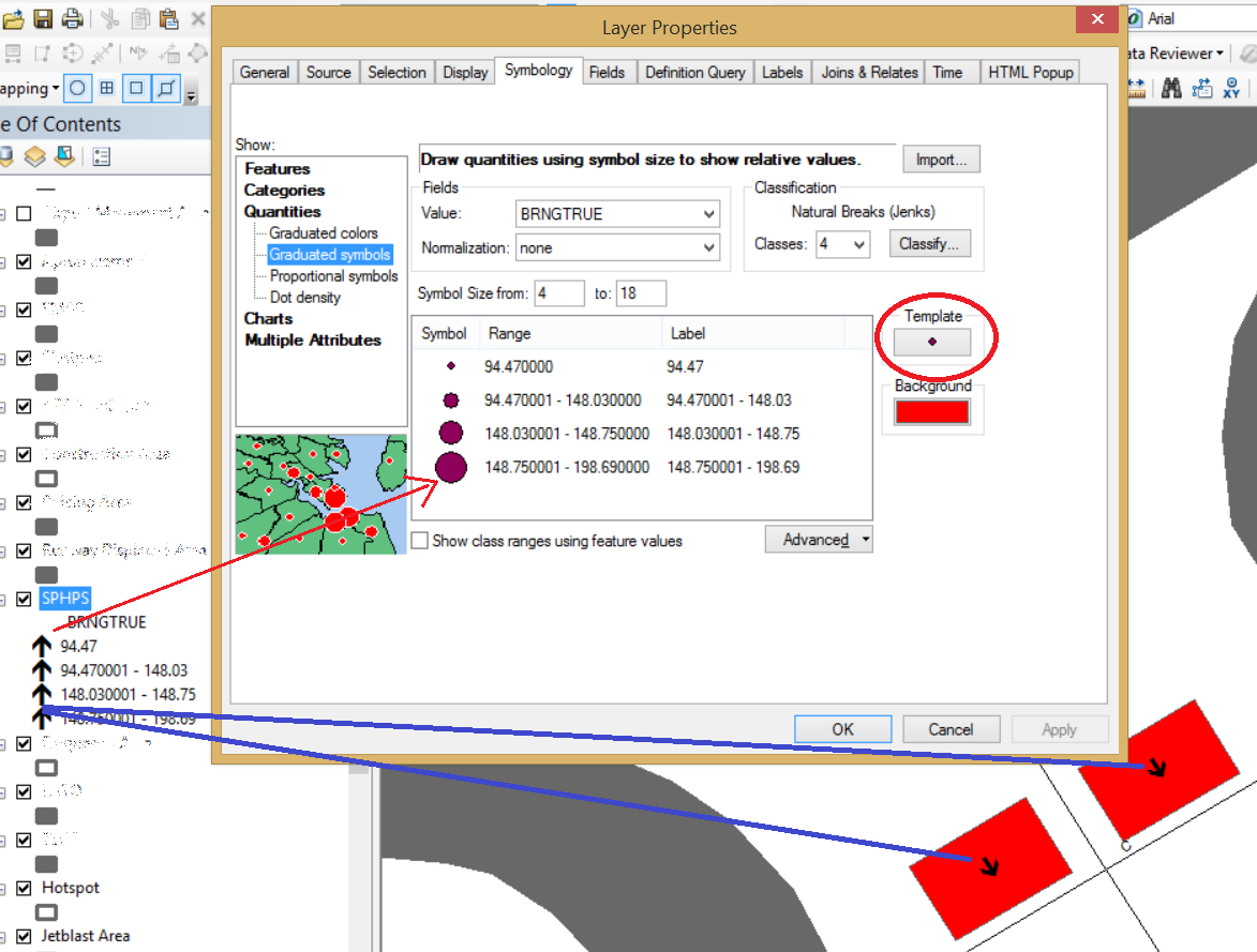

Assigning the Quantities - Graduated Symbols for one field. The TOC is showing an updated symbolize but not in the UI shown in the attached snapshot.

The Legend Info has to update then it will display the symbols correctly. Posting it here may help someone who is looking code snippet.
ILegendInfo legendInfo = classBreaksRenderer as ILegendInfo;
legendInfo.SymbolsAreGraduated = true;
