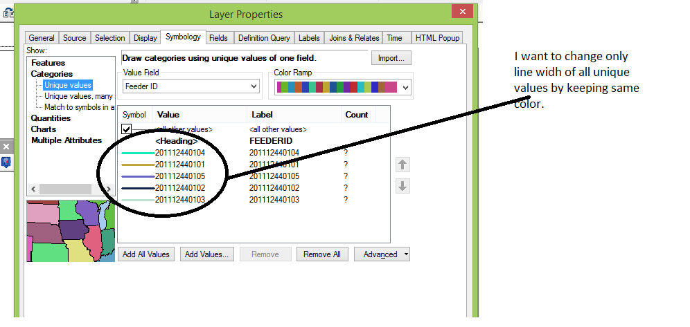

Change line width in layer properties by keeping same color arcobjects
3445
07-31-2015 10:27 PM
chaitanyavarma
Deactivated User
I am using C#for Arcobjects.
SamiEria
Deactivated User
To change the width of a line, use the ISimpleLineSymbol.Width property. Please view the following code snippet:
The ISimpleLineSymbol interface is implemented by ISymbol. You will need to cast ISimpleLineSymbol to ISymbol, and then set the ISimpleRenderer.Symbol property to ISymbol.
Please view the detailed code sample  below to see the implementation of a renderer.
