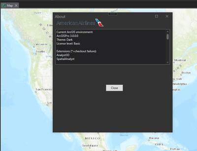

So after experimenting with a few controls I settled on a ProWindow. It is only displayed by the user action and it is non-modal. Ignore the lame graphic I have:
