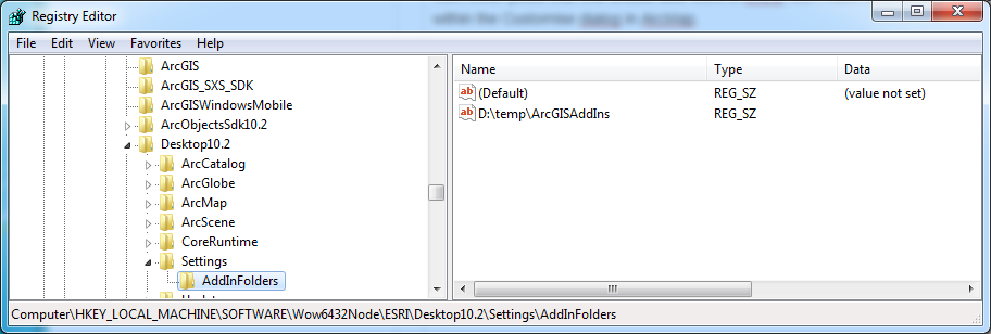

Hi
I've read in the ArcObjects 10 .NET SDK Help that it's possible to set a registry key to specify the location of a shared add-ins folder. It seems from other posts that this should also work in v10.2, but I have tried setting this as follows and cannot see the toolbar that is part of the add-in within the Customise dialog in ArcMap.
If I add the same folder location manually through the Add-in manager, I can see the toolbar. So can anyone see where I'm going wrong? Or is this not supported in 10.2?
If using the registry doesn't work - then how else can we deploy add-ins without getting every user to do this through the Add-in Manager?
Any thoughts appreciated.
John

According to what I've read, the way to do this in 10.0 is to use \\HKEY_LOCAL_MACHINE\SOFTWARE\Wow6432Node\ESRI\Desktop10.2\Settings\AddInFolders and set the value to the desired path.  My problem is that I don't see an ESRI folder under Wow6432Node.

I'm afraid I can't be of more help, but I can confirm that setting a global add-in folder in the registry does work in 10.3. (Current documentation: ArcObjects Help for .NET developers). Note that the folder is not listed on the Options tab, but the add-in should be listed on the Add-ins tab (with the Delete button greyed out).
WilliamWiesepape
Refer to the last paragraph of this page: https://desktop.arcgis.com/en/arcobjects/latest/net/webframe.htm#AdvancedConcepts.htm  for information on how to create registry entries. Note: folders added this way do not show on the Add-In Manager Options tab.
